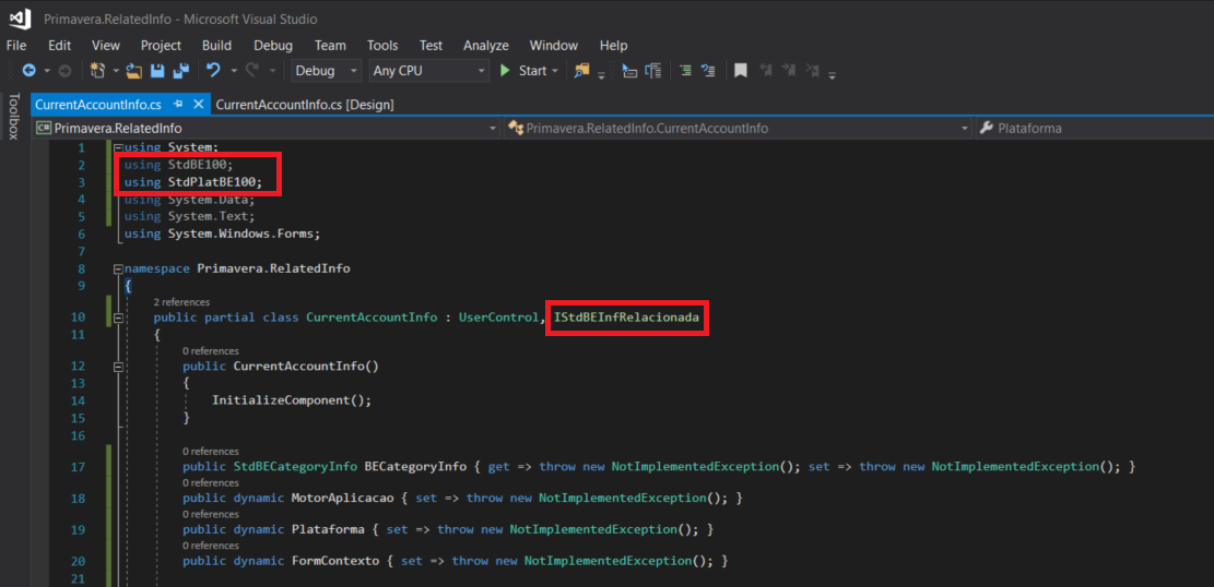

3 - After the control name add 'IStdBEInfRelacionada'. This step indicates that the 'CurrentAccountInfo' class will inherit from the 'IStdBEInfRelacionada' interface.
4 - After implementing the IStdBEInfRelacionada interface, your project should look similar to this:
 width=
