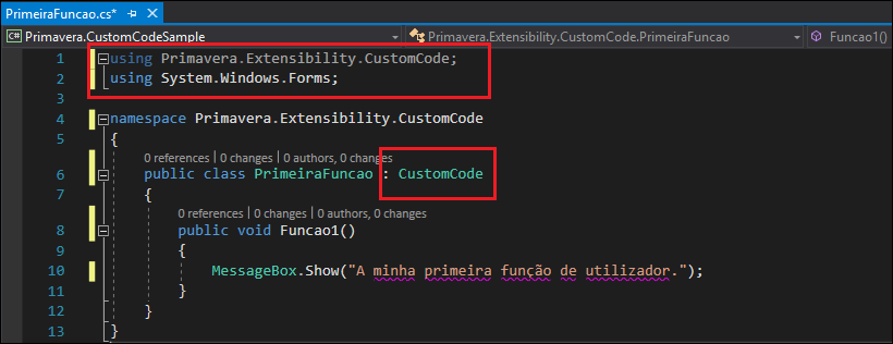

1 - Rename the class from Class1.cs to PrimeiraFuncao.cs
2 - Add the namespaces at the beginning of the class, using the using directive, as shown below.
3 - Next to the class name add CustomCode. This step indicates that our class will inherit all methods, properties and attributes from the CustomCode API base class, such as the PSO (platform access) and the BSO (module access).
4 - Create a public method with the Funcao1 name. Inside the created method, add the code as shown in the following image. All methods declared with the word public will be exposed in the ERP, which means that we can put the functions we need in classes.
